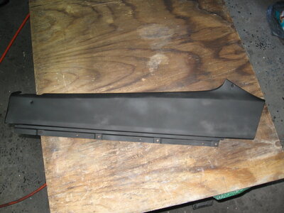

What is the interior trim under the pop out window called

So here is a pic. of it. Looking through myIMG_0101 (2).JPG screw pack want to use the rite one's. Think the one in the front upper and the back upper should be plated. The bottom probably not. Any help would be grate Russ.

The screws that are on the upper part are plated, cant remember about the lower

The other question is when mounting it their seems to be a gap at the door jam is their a piece of rubber that goes their to close the gap. May be the wind lace dose that. Any one have an answer would love to here it. Russ.

Chrome screws in the front and rear upper holes. Little short screws (plated or un-plated, doesn't matter, you cant see them) to attach the panel shown above and the trim strip (stainless w/ A87, painted w/ non-A87) that the rear, vinyl covered cardboard trim panel slides up into. Plastic sheeting goes between the body and the cardboard panel to prevent moisture damage. Performance Car Graphics sells an entire kit for this including the adhesive strip to attach the plastic.

The wind lace will go under that piece at the door jamb

I thought so. The slip with the screw pack is a little bit much to be desired. Think I can call the guy's at part's mix where I got them and maybe he can help me out on the rest. I have the chrome trim the panel slides into for the doors and the back seat area. Think I am getting tired. Have done so much on this car that I am exhausted trying to figure thing's out. Thanks for the help.
Thanks ACME A12. Noticed the old Plastic shield had glue on it. Now have both side's. I must be getting tired of trying to figure it all out. Getting close to the end now. So I think. The rest should be a breeze. Sounds like you are getting you car done also. Maybe it won't be long and it will be on the road.
