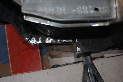

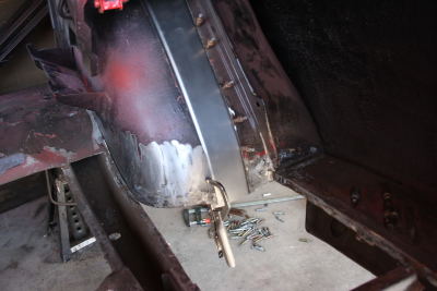

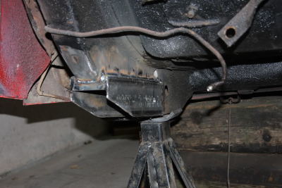

Sorry guys for my late response. The 8-3/4 rear was narrowed 3.5" per side, and you are correct I mini-tubbed the rear wheel wells by adding a 3.5" spacer. I manufactured my own hangar bracket and cut out the frame and welded it in. that gave enough room to fit the 15" x 12" cragars and the 29.5 x 13 Mickey Thompsons. The front are 14" cragars. Here's some photos of the assembly in progress.
