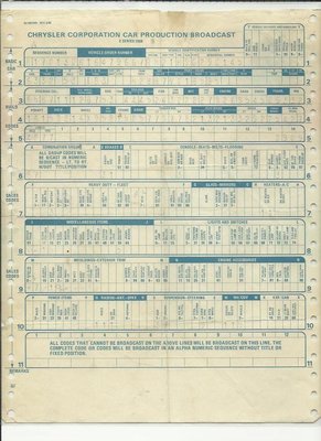

Do any of you 383 guys have a broadcast sheet, it shows the battery on it. It might be a group 27 with A/C :huh: I bet if you called Mancinies they could tell you!

Re: Where do I get a MOPAR battery and what color spark plug
I got a stock 383 no AC. My build sheet says: (O.K. I just did that to piss Bob off) I'll start over. My Broadcast sheet says: F23 for the battery which is a Group 24 59 Amp/Hour 375 CCA with yellow caps. I have nothing marked for which alternator it came with, or I don't know where to find it?
