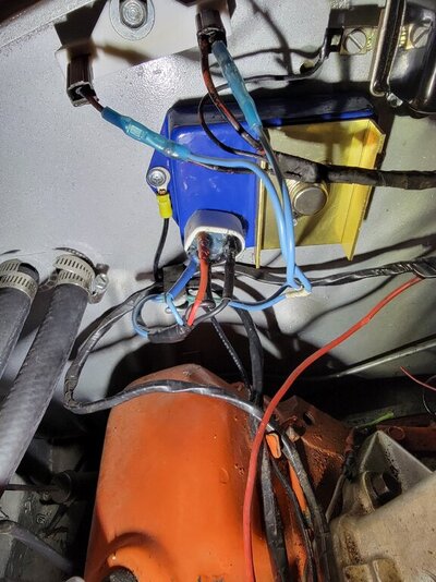

Ok not getting fire to anything. Car will turnover that's it. Ignition switch?

Possible. Russ, did you print off the wiring diagram? If you trace the BROWN wire back from the coil to the ignition switch, turn on the ignition and test for power.
Ok will try that
7,705
Have you checked the fuse link at the fire wall? Do you have power coming to your blast resistor? Without being their it is hard to walk through the system. Go to the wiring Diagram on here and start at the beginning. Do you have a new start run relay? Also check to see if you have a good ground. The ECU must have a good ground also.
I believe this ground is good. I'm gonna have to redo the bulkhead. I have fire there but it's in bad shape

I don't believe I have the start run relay. What is that?

that wiring is a mess and could be the problem buy a new engine harness from year one .

I'd pull the bulkhead connector apart and spray it with electrical contact cleaner. If that works you can either coat the contacts with dielectric grease or as V.R.D. suggested, replace the engine harness.
