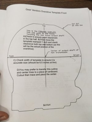

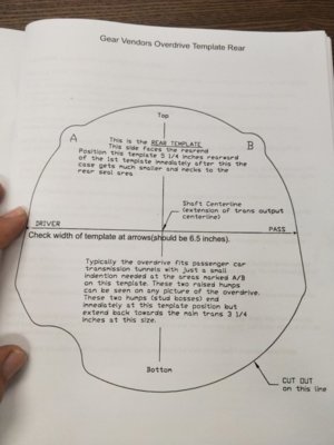

The documentation that comes with the unit is very thorough. They have a couple of templates to check spacing, as well as all the info and instructions you need to install, wire up, and adjust driveline angle etc. Havent installed it yet, but I dont imagine they could make it any more straight-forward.
