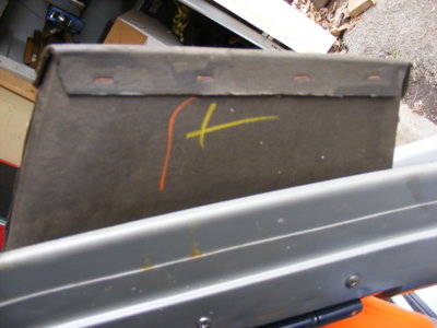

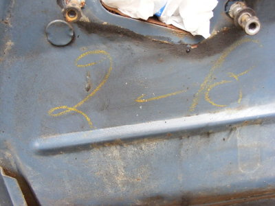

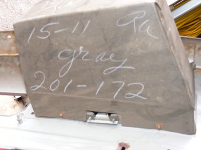

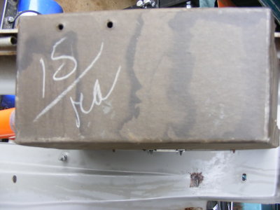

I took some pics of the assembly line markings. I thought it might be interesting.
Top of the glove box
Back of the glove box
Bottom of the glove box.
Firewall

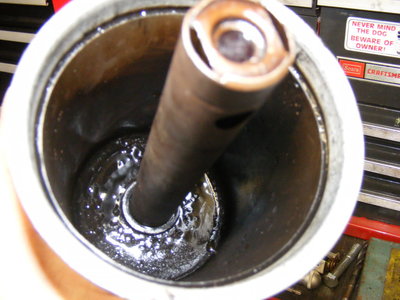

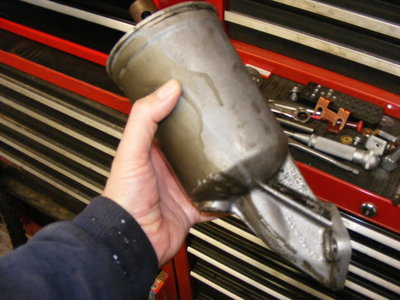

The big stumper for me right now is figuring out how to take the oil filter housing apart. I'd like to get the tube out, but I don't know if it's pressed it or screwed in.

those markings are neat. I remember my Father in Laws '41 chevy having those on the firewall.
I just got replaced as the board hand model :lol:

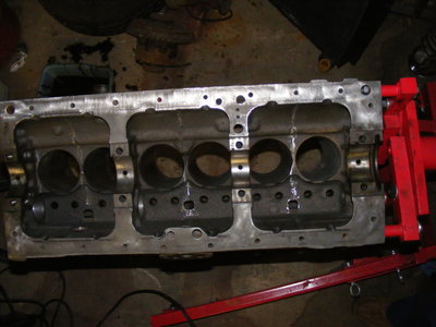

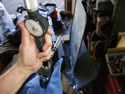

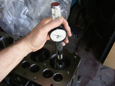

Started getting the engine together. Doing some bore measurements here.
Setting up the bore gage with a micrometer:
Measuring the bore.

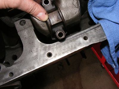

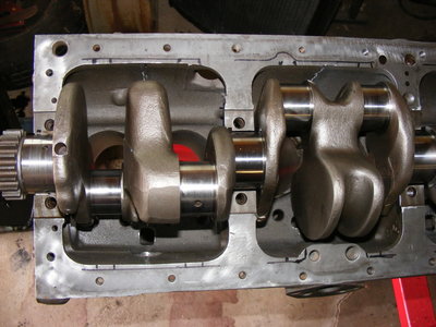

I'm using a '50 251 cu in. engine block with a 265 cu in crankshaft from an industrial engine (came out of a combine). The added stroke will cause the rods to hit the block. While later blocks had some reliefs cast into the block, I had to cut my own.
Showing the interference:
I put a pan gasket on the pan rail and marked it out. That would be as far as I needed to grind back. The crank is setting on the old bearings, one on each end.

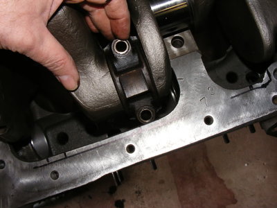

Relief cut using a die grinder, now there's plenty of clearance:
Finished block, while I was there I cleaned up the casting lines and flash:

I would guess threaded on the filter tube. From a production stand point, I think it (but who knows from way back) would be easier to have someone thread it together than to press it. Not to mention limiting serviceability. Slide a punch through those side holes and see what happens. It's a 50 50 shot right?
It doesn't seem to come apart. This is kind of a rare piece and I don't want to screw it up, so I posted on an old Mopar forum and no one else has figured it out either. Everyone that responded said they have just cleaned it the best they could by soaking it in solvent. The good thing is the tube is after the filter, so it doesn't have the sludge that the rest of the engine did.
