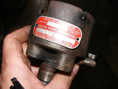

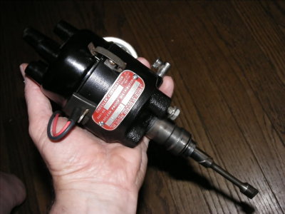

The distributor needed an upgrade.

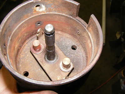

Stripped the parts off and I ground the rivet off from the inside to preserve the cool ID tag.

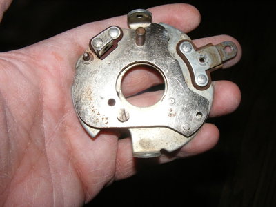

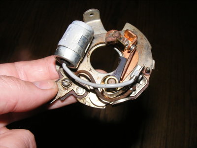

Breaker plate with points and condensor. State of the art for 1953!
Cleaned breaker plate.

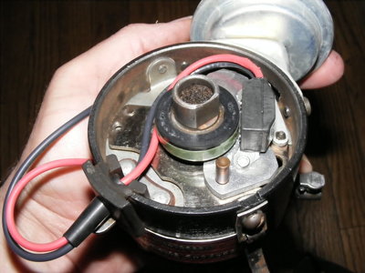

Pertronix ignition module in place.
Cleaned, painted and assembled with a NOS vacuum advance.

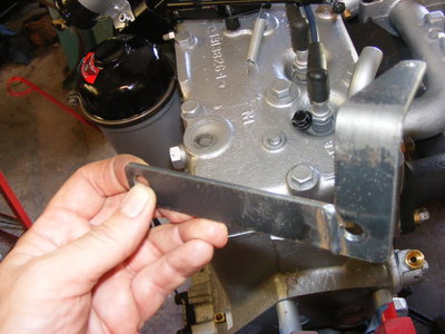

The original throttle return was an eye screw threaded into the top of a head bolt. I'd have to modify a head bolt if I wanted to do it that way, so instead i fabricated a bracket to bolt to the side of the head.

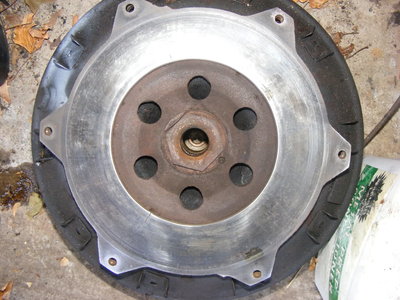

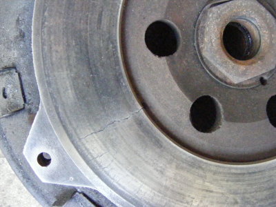

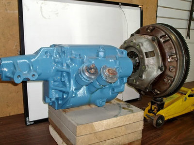

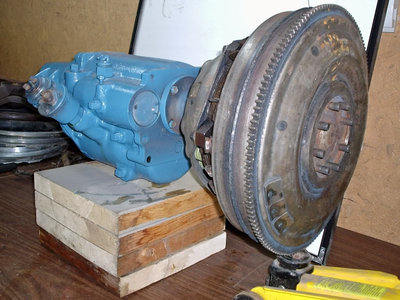

Getting the fluid drive ready and I hit a snag. The drive face for the clutch has a crack!
Good thing is I have a spare fluid drive.... Bad thing is the spare has bad seals and the drive face needs to be refinished. I have to remove the good face, have it ground and switch it to the good fluid drive.
This isn't mine, but this is what I'm dealing with. The fluid drive is bolted to the engine, then a clutch between the fluid drive and the trans. The transmission is 2 speeds with 2 ranges. It's shifted between the ranges manually and between the speeds automatically by the solenoids on the side of the trans. You only use the clutch to engage reverse or shift between the ranges. To shift speeds, you lift your foot from the gas and wait for the "clunk" to tell you it's shifted.
The low range is really just for hills and pulling stumps. To drive it normally, you select high range and then never touch the clutch, letting the solenoids and the fluid drive do their thing.

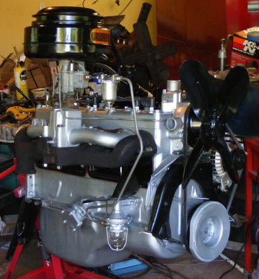

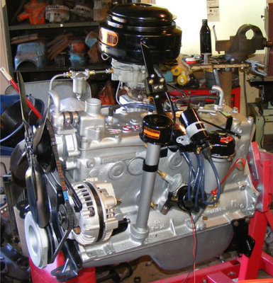

It's ready to come off the stand and start attaching the bellhousing and trans.
13,695
858
That is really a nice looking engine. Love the time warp between the flathead and the much newer technology alternator. Really a slick piece. :thumbsup:
10,552
308
That looks great John. After having a '41 Plymouth myself, that engine does look a bit strange with that alternator on there, but I understand why it is.
