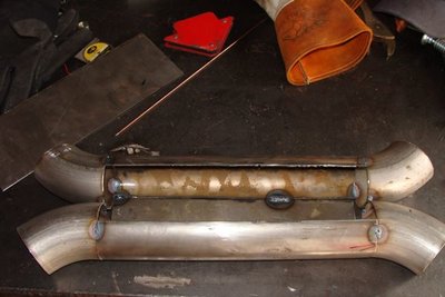

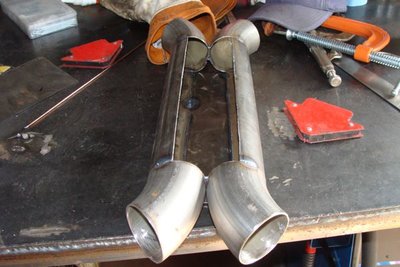

Back to back dyno test on a 1000hp car (880 at the wheels) open header made less HP than 4 inch magna flows with the tweak chamber. IIRC it was minimal but it made significantly more torque in the mid range and adjusting the length of the chamber moved the peak torque around. Pretty cool. BTW I didn't come up with the idea (I wish), my propeller hat wearing engineer buddy engineered it.
