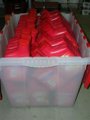

i am using amsoil 10 40 high zinc formula
:yeathat:
