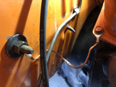

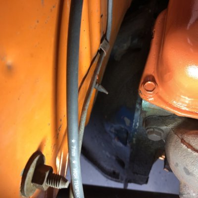

OK here’s a picture of the passenger side engine block trans area.
I don’t see any ground?

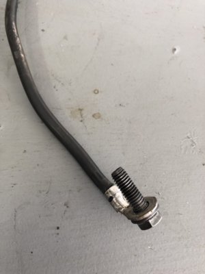

I was going to use this negative battery cable from the firewall to a trans bolt?
I put this valve cover to firewall ground also I put this valve cover to firewall ground also and I tested Both sides disconnected both ways
7,713
3,251
I would prefer one from a starter bolt to the battery or too the frame. Yes make sure all connections are clean. :thumbsup2:

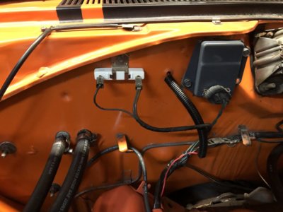

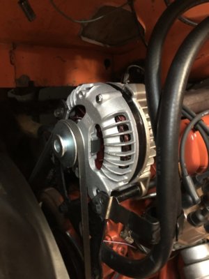

3105B7F1-EC59-41EA-980B-60524413AE2B.jpeg 5EAB13F1-2D1B-439E-91DA-F0E5713A2AF0.jpeg I have my New 1 Groove alt and voltage regulater and ballast resistor installed back to normal!
Charging fine 14 ish I still have an analog tester.
The ugly red wire is my ele choke wire
And no I didn’t drill a hole it was a plastic grommet hole that I put the wire through haha
7,713
3,251
Is their a rubber grommet around that wire if not I would put something their so the wire dose not chafe on the metal hole. Wires do move you know. Russ. :thumbsup2:

22,145
2,356
The inverted hole in John's pic is used for a plastic nail that holds the firewall insulation up that someone repurposed it for a wire, so the grommet size would be a mystery.
