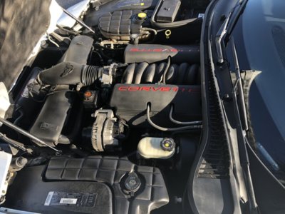

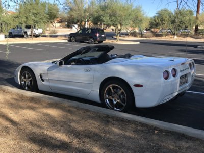

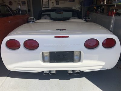

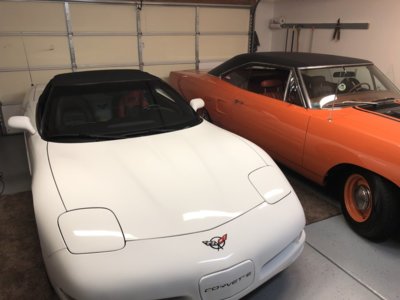

Not up on what they are going for now but sound's like a good deal. I remember when they said they would not be making any more at one time. Knew that would not work. Have fun driving it buddy. :thumbsup2:
