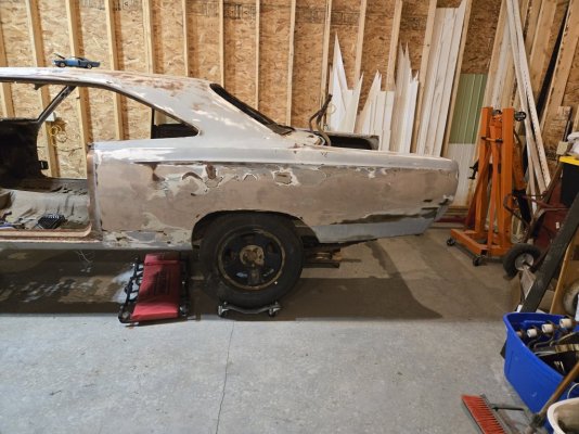

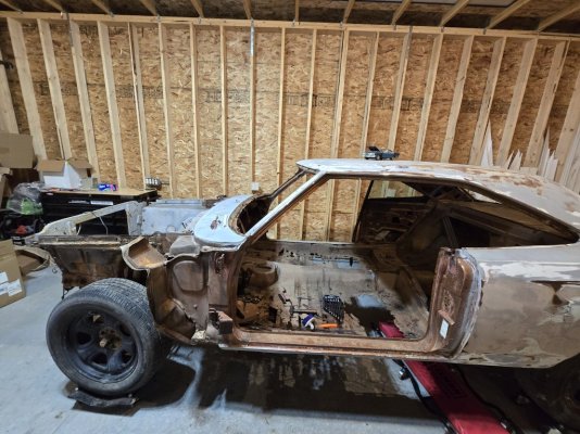

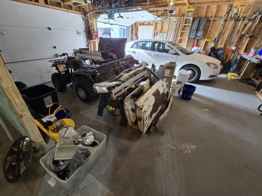

Technically, the restoration process has already begun. Take a peek at the attached pics.

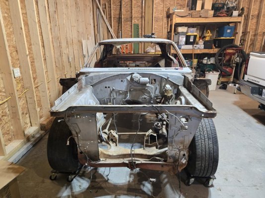

Front clip photographed, removed, inventoried, cataloged and missing parts list generated. Tracking all model and part numbers via spreadsheet.

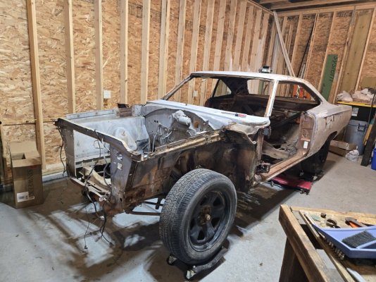

Front Drive's side perspective. Note: front windshield was completely shattered with no less than (2) large holes.
Front shattered windshield temporarily stored with completely intact rear glass.

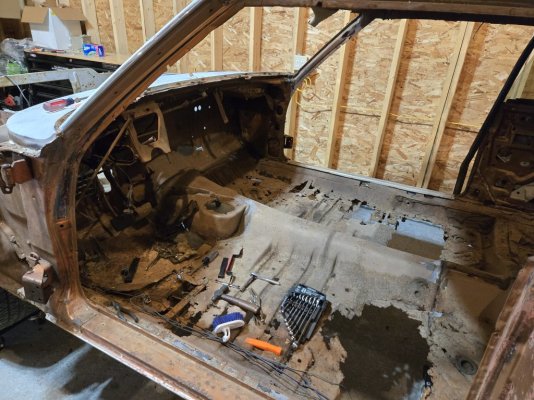

Driver's side: Removed- Door, Steering column, Bench Seat, Dash and insturment panel.
Working on Clutch Support Assembly. New floor pans are on the Replacement List.
Rear Driver's side quarter panel. Chemical dipping will reveal replacement panels and imperfections to be fixed.

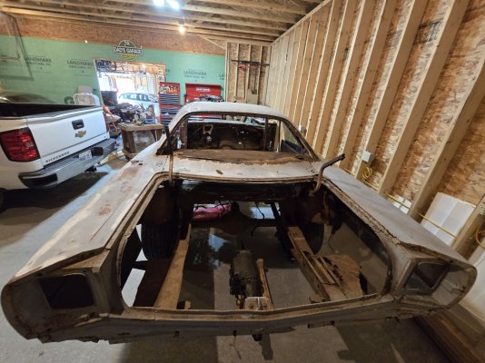

Yup...no trunk pan, extensions, no rear bumper and fuel tank. Trunk lid, rear extensions, and taillight Assemblies photographed, removed, documented, inventoried and carefully stored in their respective labeld boxes.

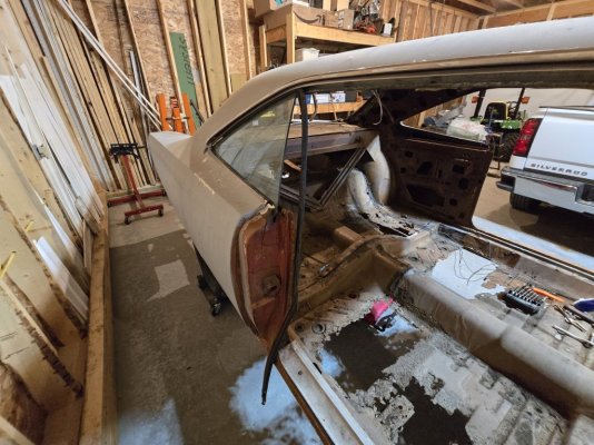

Passengers side image: no back seat included, new floor pans required and rear manual window intact and operates!

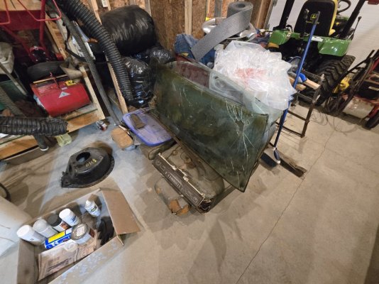

Parts Storage: Front Bench Seat, insturment cluster, front windshield, rear windows, gas pedal pad.
Parts Storage: lower grille, Driver's/Passengers doors, steering column, upper grille, Driver's/Passengers Fenders, trunk lid, front windshield trim, hood, and dash
Let me know what you think. This is my first restoration. Am I heading down the right path? And guidance and advice?

Organization is total key to success. You seem to have a good start on it. Some parts are harder to find than others. Such as trunk lids and rear seat. Having that much room to work is also a big plus. I’m jealous. Best of luck and welcome!
