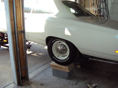

I do not mean to advise anything that could be construed as unsafe, and you make a good point John, but if you'll look closely, I've put my floor jack under the diff. There are also other safety precautions I took, such as placing tires under the car before working on it. The idea here is to some how take the place of a lift, which is the ideal situation. Jack stands are at their safest when at the lowest setting. They can be a bit unsteady when extended. Larger jack stands are your best bet, but getting the car high enough can be another safety challenge...... Just my two cent response..... :cheers:
Please dont do the block under the tires. Take it from someone who made a questionable decision and almost got killed and ended up in the hospital for my efforts. Approved jackstands (placed under the frame) and a floor jack are the safe way to go. I have seen a few people crushed by cars falling on them and its not a pretty way to go. If you get the front up as high as the jack allows then place the stands under the front frame and then go to the back and do the same. Then do this over again 2 more times until the jack can no longer pick the car any higher, that is high enough to get the trans out from under the car. I also slide the trans on a piece of cardboard out the front manuevering it between the k frame and the lower control arm (which will have the most clearance). If you are just changing out a flex plate or something then you can just leave it on the jack. Thats the hardest part, getting that heavy mother on the jack. I use 2 4x4 blocks of wood and pivot the trans on them front and rear until I get it high enough to get it on the jack. I also went down to Harbor freight and bought a motorcycle lift for 79 bucks and it worked killer.
The weight of the vehicle in the picture I posted is not entirely supported by the block & wood set-up. Most of the vehicle's weight is supported by three floor jacks - one of which is in the pic. I then stacked some tires and wedged them under the frame. The cinder block was a 12" block laid on its face, not side. It was more of a safety measure than weight support. I appologize for a "shade-tree" answer to a legitimate question. The best way to service an automobile is to have the proper equipment, in this case, a lift - period. Any other approach requires the upmost of care and planning, and unfortunately requires one to assume some risk. Additionally, in the pic I posted, I was not getting under the car but simply raising it so I could slip the engine/trans assy under it. Once in place, it was lowered onto jackstands for final assembly to the car.

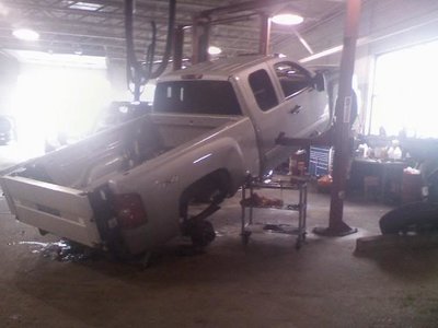

My son was standing with his back turned, just a few feet from the back of this truck. I saw a Firebird fall off a lift once too.
It's ALL about common sense when it comes to safety. If it looks unsafe... IT IS! If it looks safe, check it again and only then trust your life with it.
Yikes! That's scary... WTH happened there???
I've witnessed that scenario more than once in my career....Oh the stories....
Glad your son was not hurt!
Those Tommy Lift tail gate are very heavy. It looks like it was not centered correctly. Glad no one was hurt.
The lift wasn't positioned correctly and yes, the Tomy lift wasn't taken into consideration when the truck was put on the lift. An experienced mechanic didn't think because he had done it so many times before.
So many times it's the person that's gotten too comfortable with what they do and they get careless and then someone gets hurt.
Dont get me wrong. That comment wasnt necessarily meant towards you, I dont know the story about how you did yours. A lift is a luxury and a good set of jack stands manufactured from a reputable source is really the safest. I had an arm on a lift break back when I was a "pro" and it almost killed me. It looked exactly like the pic that John posted. The lift was 30 years old and had enough and just snapped one arm! I wa under it at the time and got wrapped up in the undercarriage and couldn't get out from under it. Fortunately it just fell part way down until the rear bumper touched the ground.
No biggee... In my 35 years as a professional auto tech, I have been very cautious and probably lucky - knock on wood. That is not to say that I have not witnessed a few mishaps in my career. Regardless, I'll pick a lift over crawling on the ground any day. This particular pic is when I was re-installing the engine/trans/suspension as a unit. I did not feel like trailering the car to the shop, and the procedure is pretty straight-forward... at least for me.
