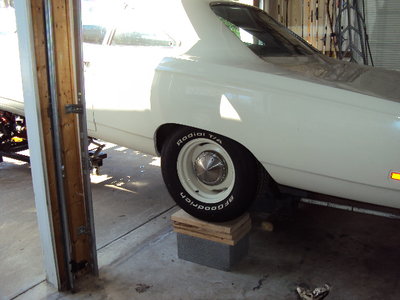

Try this at all four corners... add the 2x12 sections to taste... Don't forget the e-brake!
For added stability you could use two cinder blocks and longer boards. That would also give you room for wheel chocks.
:thumbsup:
I would stay away from using the cinder blocks if it were me. Yea, I know.... we've all used them at some time or another but after reading a few horror stories, they really aren't a good choice. The blocks aren't made to support that type of weight and can break or crumble. I really don't like blocking up jack stands either.

I do not mean to advise anything that could be construed as unsafe, and you make a good point John, but if you'll look closely, I've put my floor jack under the diff. There are also other safety precautions I took, such as placing tires under the car before working on it. The idea here is to some how take the place of a lift, which is the ideal situation. Jack stands are at their safest when at the lowest setting. They can be a bit unsteady when extended. Larger jack stands are your best bet, but getting the car high enough can be another safety challenge...... Just my two cent response..... :cheers:

The weight of the vehicle in the picture I posted is not entirely supported by the block & wood set-up. Most of the vehicle's weight is supported by three floor jacks - one of which is in the pic. I then stacked some tires and wedged them under the frame. The cinder block was a 12" block laid on its face, not side. It was more of a safety measure than weight support. I appologize for a "shade-tree" answer to a legitimate question. The best way to service an automobile is to have the proper equipment, in this case, a lift - period. Any other approach requires the upmost of care and planning, and unfortunately requires one to assume some risk. Additionally, in the pic I posted, I was not getting under the car but simply raising it so I could slip the engine/trans assy under it. Once in place, it was lowered onto jackstands for final assembly to the car.

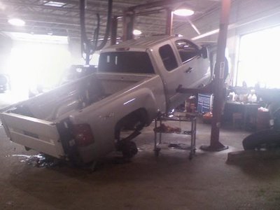

My son was standing with his back turned, just a few feet from the back of this truck. I saw a Firebird fall off a lift once too.
It's ALL about common sense when it comes to safety. If it looks unsafe... IT IS! If it looks safe, check it again and only then trust your life with it.
13,677
829
Yikes! That's scary... WTH happened there???

I've witnessed that scenario more than once in my career....Oh the stories....
Glad your son was not hurt!
724
Those Tommy Lift tail gate are very heavy. It looks like it was not centered correctly. Glad no one was hurt.
The lift wasn't positioned correctly and yes, the Tomy lift wasn't taken into consideration when the truck was put on the lift. An experienced mechanic didn't think because he had done it so many times before.
So many times it's the person that's gotten too comfortable with what they do and they get careless and then someone gets hurt.
