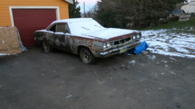

got the car in Snoqualmie (that's why it is heavily covered in snow compared to everything else). It is hard to see but under all that growth, primer, and rust, is the original coat of gold paint.

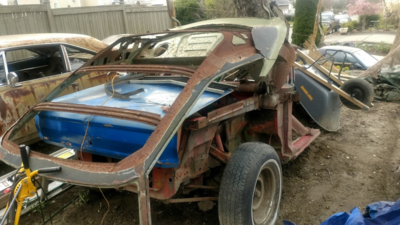

That is parts car #1 I had bought it when I was 13 years old along with another coronet and had plans to put the two together into a two door coronet.

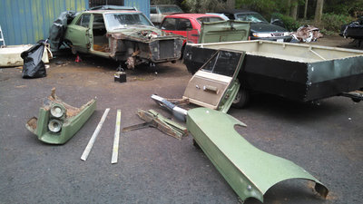

There is the other coronet. This one is the two door. and can you believe it has now become the mess of body parts below!
Parts pile required to help build the car.

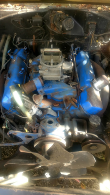

professionally, and I use the term loosely, painted engine. Lucky for me, it is numbers matching drivetrain, except the trans. It must have been replaced at some point.

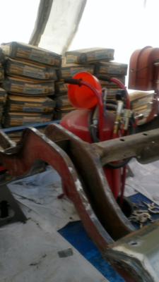

This is the donor rear frame from one of my parts cars (the half a car pictured above)

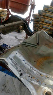

Here is the donor rear floor pan out of one of my parts cars

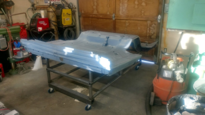

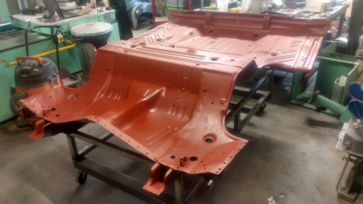

Have the rear floor pan, new trunk pan, new tail panel, new rear cross member, new trunk extensions, and the spare tire mount all welded on the sand blasted frame.
And there is the finished rear assembly! On the top, it is sprayed in red oxide primer for now, but the finished underside is painted the final color.... Plum Crazy! Now that the rear assembly is ready, it is time to get the car ready for it.

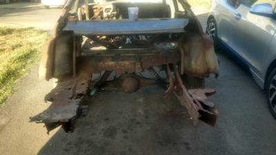

I think there is going to be a lot of cuts and tetanus shot by the end of disassembly. I still to this day do not understand how this car did not collapse! Half of the passenger side frame rail is gone! The rear clip, or the chunk that has been removed already (By removed I mean fell off) was only attached in two places! AND, I didn't have to remove the trunk pan or gas tank... mother nature already did it for me! Now you can see why nobody(except me) would touch this car with a 10ft pole. Half the car is scrap metal at best. I bet if you took it to a crushing yard, they would pay nothing for it.
