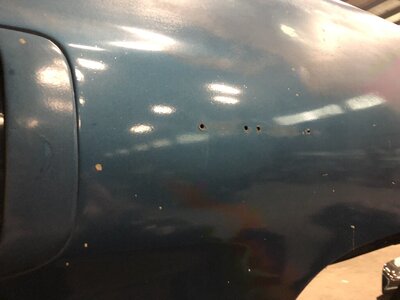

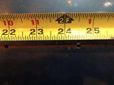

I measured the emblems in relation to the studs.
- The distance from the centerline of the stud to the edge of the letters "R" and "D" in road (RoaD), is exactly 3/16". That distance is the same for the "R" in runner (Runner), 3/16".
- The distance from the edge of the last letter "R" in runner (runneR) to the centerline of the stud is 13/16".
[You can also see this with 1968 man's picture of his emblem with studs on page 1. The stud is further away from the end on the last "R" in runner.]
- The gap between the words road and runner is exactly 1/4".
So using that and 1968 man's layout dimensions, you should be able to place your emblems without studs.
You might lay that out on paper first and see if that makes sense.

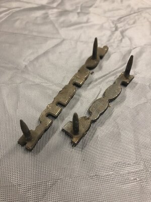

I don't have the holes for the emblem.Did all 70 roadrunners have this emblem at the scoop or could theholes have been filled at some point due to bodywork?? Also is there a version of the emblem that does not need holes drilled in the body?
If the quarters were replaced there wouldn't be any holes. I have a set of NOS stick on emblems that I would part with for a decent price. If you want to drill the holes, here's a diagram to tell you where to drill the holes.

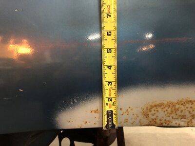

Well it’s cooling off here in the desert somewhat and I’m thinking about applying my 70 RR badging to the quarter panels(adhesive type).I need to know: Am I applying them level to the ground as a bubble level indicates or am I applying them in relation to my dust trail decal after taking the measurement from the leading scoop edge and using that dust trail as my template??

I would think since you have the dust trail, you have to install the emblem on the same line as that.

That’s my thought. I’m thinking of using the bottom line of the dust trail to follow over and past the side scoop.
It seems by looking at a lot of 70’s that other than getting the measurement from the scoop rearward,that it seems to be at the right spot. When I put a small level on the dust trail where it runs into the scoop it is not level to the ground. So it will run even to the trail and look right when viewed.

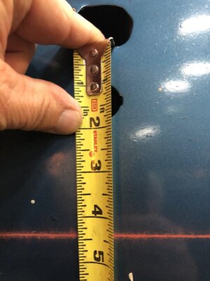

Well after much measuring and stressing out I came to the right distance from the leading edge of the scoop and used the bottom edge of the dust trail as the base to place the emblems and a little scotch tape overnight in case that emblem tape lets go. Gotta have a beerskie after that and hope for a good repeat on the other side tomorrow.

You could double check what you have with post #65. If they are close, go for it.

This the final result unless I of course get all anal about it and find something wrong and try to fix something that may or may not be there. Even back in the day they didn’t do little detail work perfectly.
