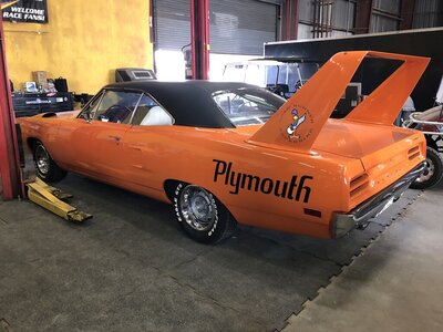

Looks pretty good! You are lucky you still have the existing holes to go of of...i do not! I would only go in behind the backseat as you suggested and locate the holes and see if they were filled and be able to pierce the filler and not ruin the otter finish.Unless for some reason in this cars life it was made into a clone,but the fender tag does not indicate it was a Satelite,which is good to know. Less holes in a 50 year old car the better. Don't know if there is a factory emblem that can be attached with adhesive,HOT here in Arizona,it would probably melt off.
Thanxs for the effort!!

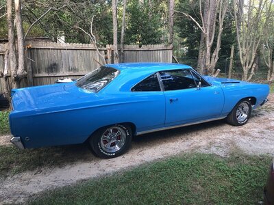

Some Super Birds were turned in to regular road runners so they would sell. Boy that’s hard to believe but a true story. See no emblems F9A664EC-9979-49FB-A207-F42AFFCE1811.jpeg

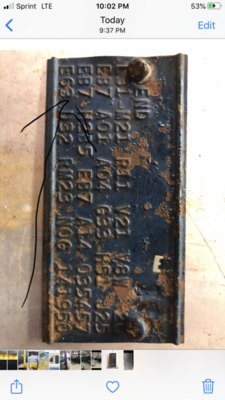

So from 68-70 a RR could be RM21 and or RM23? Is that RM21 or RM23 designate it has a certain motor or given options?

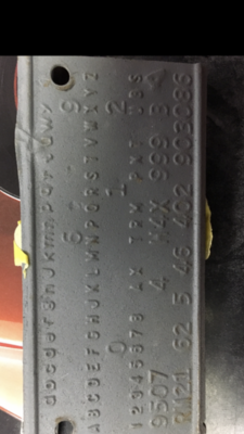

41B0DD9D-81EF-4CA0-B5BA-8E13523A9BD1.jpeg 4BA9DE63-1E4B-4FCA-B9F2-C1BC6E4F7578.jpeg I’m almost sure RM21 is a coupe and RM23 is a hard top. The hard top has roll down 1/4 windows and the coupe would have pop outs.
