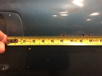

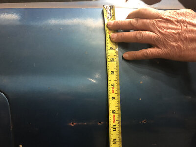

I am so glad this thread came to being. I thought I had drilled holes for the RR emblem on the qtr panel, but didn’t. Before replacing the qtr panel with the OEM style, I had used a patch panel that didn’t work out well. THAT one was drilled!
Following the dimensions here, it looks pretty good. It seems to be very close to the same level as the lower flat in the door opening. That looks to be about the only possible surface that would be good to measure from.

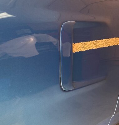

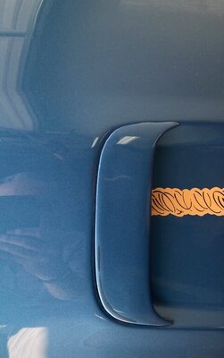

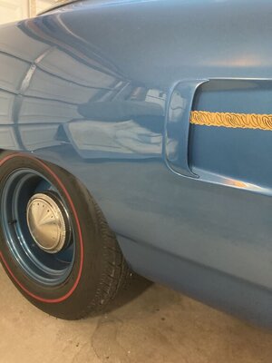

It seems when I look at pics of the emblems they seem to be placed at a position just north of the 1/2 way point of the side scoop. Now my car has a dust trail decal that puts it at just north of 1/2 way. So my plan was to use a laser line level off of t

Sorry about that,internet issues today or me! The other part of my post: Am I trying for the emblems to be level to the car or the ground?

I used the dimensions that '68 man had on page 1. Using his, it looked pretty good. I tried to find a surface level with that same line to double check as my car is on a dolly. The only one I could find was the lower horizontal surface of the door opening. Both side were right on with his dimensions, and so I used that. Standing back, it seems pretty close.

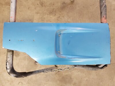

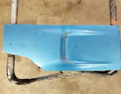

Those holes in your old template are useful for you if you have it in your haznds and can measure it. All I have to go on is like I said earlier is the dust trail decal that I can reference for level. My other issue is the measurement from that trailing edge of the scoop to where to place the runner emblem and then the road emblem right next to. If I didn’t have the dust trail I would be lost.

I believe 68 man has the dimension from the beginning edge of the quarter to the first hole, something like 18-7/8”. I have the emblems off my car and can give you the dimension of the studs in relation to the leading edges of the emblems. That should give you what you need to place them properly.

No problem. I finally figured out your issue and that is going by the centerline of the holes do you no good since your don’t have the studs. I will get that info today.
