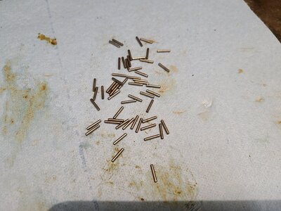

Pulled the pedal assembly from the fire wall today. While cleaning I realized the clutch pedal needle bearings are not caged and of course they proceed to start falling out, all 54 of them. Ordered a new set from Brewers and they claim the bearings should have a cage. So how do I pull the races and install the new ones? Also who sells new manual brake push rods? The end of the rod is actually bent and corroded. Are the adjustable rods good?
7,705
The adjustable rod's are good. Classic has them. So are they coming out of the Z bar. That Works the push rod to release the throw out bearing. It only has nylon bushings on the 69 runner's. To get it out access the nut through the fender well. Or are you talking about the top of the clutch pedal in side the car. If so the brake pedal and clutch are on the same rod mine has bushing's and not roller bearing's. Your year runner is different than the 69 runner's. May be if you call brewer's back they can give you a better answer. Hope this was some help. Don't want to steer you wrong and maybe some one else has a runner like yours on here that can be more help.

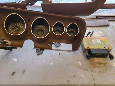

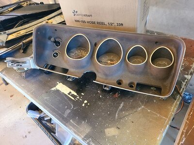

Built a jig to hold the dash frame yesterday and today I have it stripped. So now more decisions to make.Do I replace the instrument cluster or reinstall the after market radio? I bought the car 26 years ago and it had a non stock 8 track player and I replaced it with a cassette. My E body is an easy fix, just replace the lower bezel but the B body could be expensive.
7,705
Yes it is true one thing then another. We just have to move forward the best we can. You will get it figured out I am sure. :beep:

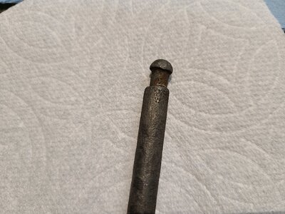

Since I have an old instrument cluster that hasn't been butchered I can change the whole piece or just change the fascia/bezel. Now the next problem, I can't remove the light switch and wiper knobs. Any tricks? I removed the set screw from the wiper knob still won't budge.
7,705
JB blaster and let it soak a few day's. If not then vinegar and water it may take several day's to work also. My buddy had a brake cable that cost 100 dollar's on a golf cart that was froze up. Put it into the tank of vinegar and water for about four day's. It freed up and used JB blaster to finish cleaning it out. It worked like a charm. Three part's distilled water and one part vinegar. It wont hurt paint.
