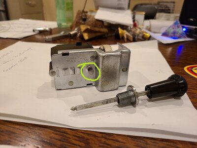

Sorry Russ but can't wait a couple of days. My wife says I have no patience but I tell her I have a lot cause I never use any. Got the wiper knob off with the use of some vice grips, only way my old hands could hold it. Didn't mar it much. For the light switch it took a little research and found some info on the a body site that mentions a button release and sure enough I found it and the knob pulls out easily.
Their you go. Thanks for sharing that info with us. In restoring a car you have to allow some time for things to be fixed. Yes I can relate to not being able to use our hand's like we use too. Good job buddy. :thumbsup2:

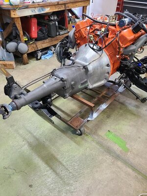

While I am waiting for the body and paint I am getting the running gear ready for install. This will be my first attempt at sliding every thing under the car and I am not sure if should attach the transmission cross member to the transmission or wait until after every thing is in place.
Let me know how it work's out for you. I am going old school put motor in like I took it out. K member in the car. Motor bell housing with clutch and all on the motor. Going to put the transmission on under the car. Then put the four speed shifter on. Like I said that is the way it came apart. Good luck and I mean it. :thumbsup2: :beep:
