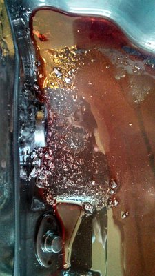

Pulled the old transmission pan today. I found a lot of metal shavings in the pan. Don't like the looks of that. What are your thoughts? Bad, OK, or Good to go?!
In the picture you'll notice the "bung?" opening for the temperature gauge that was "mickey-moused" into the pan.

Well that doesn't look good, in the first photo I see two "E" rings or "C" clips. What are they from or were they in the pan when you removed it?

I don't know what the clips are from?? I removed the pan earlier today for the first time since purchasing the car and saw them. Could the clips be from inside the transmission? Are there any parts in the tranny that normally would use these clips?
Also, i drained out about 7.5-8 quarts of fluid. I imagine there's 1 quart left in the converter. So, the transmission fluid level was low about 3 quarts. Hence the higher temp the other day.
They use those clips in a couple places on the valve body. That and the amount of material in the pan is not good at all. I see a transmission rebuild in the very near future.
BTW, that's the stock drain for that style pan and there's a drain plug on the convertor too. You'll have to turn the engine a little at a time to find it.

the converter isn't stock; it's a 4500 stall. I believe I've read that some converters have drain plugs and some don't. I guess I need to turn the engine slowly to find out. Hopefully it does so I can drain the converter too.
In your opinion what might have caused those clips to come off?
