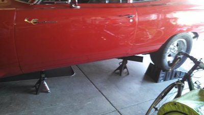

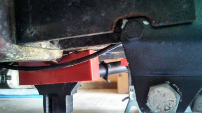

I'll be attaching some pics of my car that I've jacked up. I'm preparing to drain the transmission fluid remove the new TCI deep pan and install the old pan (in case of scuffing the pan while removing it).
inri
Jun 9, 2013
447

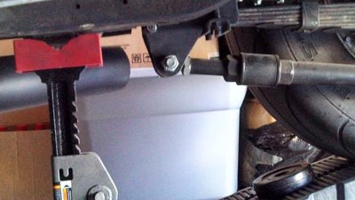

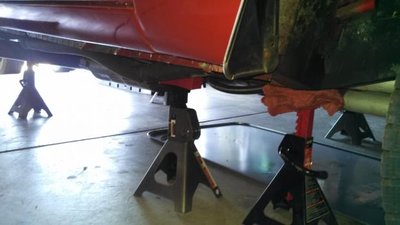

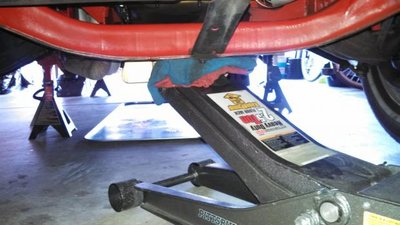

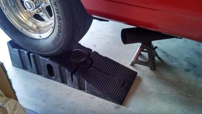

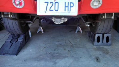

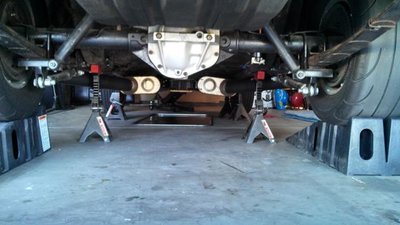

I took these pics from my phone so they aren't the best quality, but are to give a reference as to how I have jacked-up the car to prepare for the 727 transmission removal. As you'll notice I did use ramps for the rear tires but I used one facing the front and the other facing the back as to not allow any roll. The (2) jack stands near the rear end aren't touching the frame. They are about 1/8" from the frame because the rear tires are supporting the rear. The front (3) jack stands are all fully supporting the frame. And, I have a floor jack supporting the k-member.
Any other support measures I should take prior?
Thanks.
