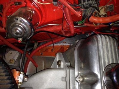

Yes I am alive... he he
Got the transmission in tonight! Hip hip horray. Installed a new transmission mount, powdercoated transmission crossmember. I am moving along!
