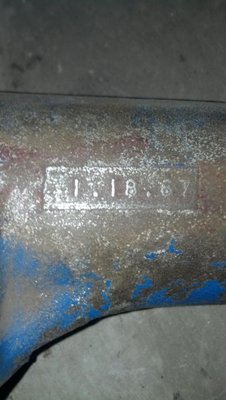

Will a 18 spline transmission with a build date 1.18.67 fit in my '69 RR? Thanks
Dude where's all the 4 banger guys when you need them?
Never mind everyone, I was able to search online and found that it the '67 a-833 will fit in my '69 RR. Thank again for nothing!!lol :rimshot:
yup. the only diff in the older 833s is '65 IIRC because they use the trunion joint, but physically they are the same.

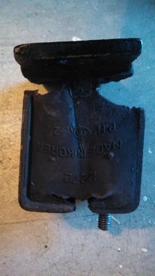

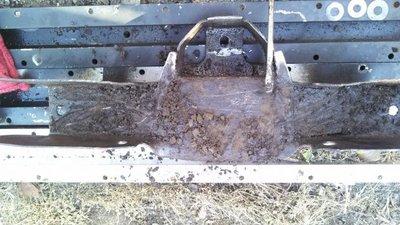

While I'm waiting for the transmission I decided to clean up the transmission cross-member prior to sand blasting and powder-coating it black. Boy oh boy was it dirty. I probably took 1/2 pound of dirt/grease/gunk off of it! Also noticed that the transmission mount reads "Made in Korea". What the heck is that? I hope this isn't a stock piece lol. Upgraded that to a new black energy suspension mount too.

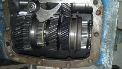

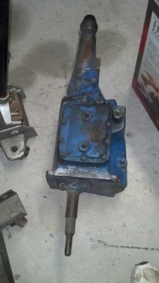

Regarding the A-833 transmission for $500 on CL; I was suppose to drive to LA County this morning but the seller said he would be out-of-town today. I was also told via text that he had a local offer of $600. I tried to find the original posting on CL but it has been removed. IMG_20131016_151106_836[1].jpgIMG_20131016_152405_522.jpg
Drove to LA this morning and just got home... ...guess what I picked up? Yup, that's right an 18 spline A-833...for...$500! HAPPY HAPPY JOY JOY LOL
IMG95201310149510385595362.jpgIMG95201310149510511595135.jpgIMG95201310149510505995766.jpg

Nice pics of your transmission. Did you pressure blast it and then paint it? I'd like to clean up the casing on the one I bought too.
I have a long road to travel before this puppy is ready to be installed. Meanwhile I need to pick up the 727 that was rebuilt in Sacramento.
Yes I did pressure wash it, removed all the old street grim. I then used a wire brush to remove any loose paint. Then I repainted it with left over black VHT exhaust manifold paint. the inside gears look pretty good and clean.
