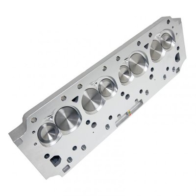

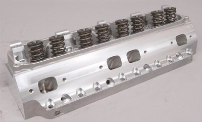

    The CNC Trick Flow heads are by far the best right now for both performance and value. No other non-max wedge heads
    flow as much. Estimates by noted engine builders are up to 50 hp over other name brand OOTB heads and only $2k per
    pair complete. Stock port locations. New matching intake manifolds available also. 10.5-1 440's 0.030 over with Trick Flow's
    .300/.600 hydraulic roller camshaft are making 620 hp on pump gas. Smaller cams (example: .540 lift) make an easy 550+ hp.
    https://www.trickflow.com/search/pr...erport-240-cylinder-heads-for-big-block-mopar

    440 Source CNC Stealth heads are very good but not quite as good as the OOTB CNC Trick Flow PowerPort 240 heads.
    440 Source CNC Stealth Airflow Results
    Lift Value Intake Flow CFM Exhaust Flow CFM
    .100" 75 73
    .200" 157 125
    .300" 220 166
    .400" 266 198
    .500" 299 219
    .600" 315 233
    .700" 321 243
    Trick Flow PowerPort 240 Airflow Results
    .100" 78 58
    .200" 154 130
    .300" 230 186
    .400" 282 222
    .500" 310 243
    .600" 326 253
    .700" 334 262
