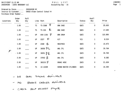

My car has the 11x3 and 11x2.5
manual adjusters
115 bucks for a fing brake drum?????? :soap: :chuck: Can't even get the rear drums? :brickwall:
all my B Bodies have had manual brakes. $115 for a brake drum sucks.when I worked at the tractor trailer dealership, we sold brake drums for the big trucks for only $60. :crazy:
