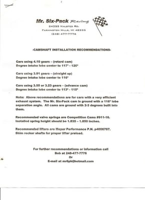

Bob at 248-477-776 or
mr6pk@hotmail.com
the cam cost me $225 but i have been hanging on to it for about 3 years now. it is just the cam no lifters. it is made by engle cams, but don't call them to try and order, this is a mr sixpack design and he holds the rights to it. here is a copy of the install instructions that came with my cam. it spells out that for my gear ratio it should be 115 and i nailed it the first try. :banana:
