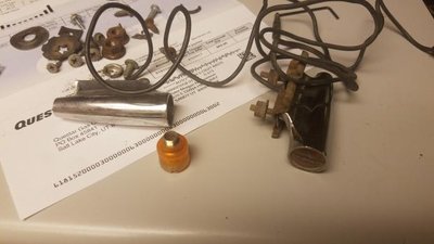

Here is my blinker. It looks like it needs a female to plug into [emoji1] . That other picture looks like the female on one end and a harness on the other. If that's the part I need I just need to find where the harness plugs into right? Or....maybe I'm way off....

69RNR
Nov 28, 2016
116
Utah
Okay, so i put on my big boy pants and crawled under there! Brrr! Its cold here in Utah! Here's the connection from the existing blinker to the existing headlight. So not quite sure how to get these bad boys to work. Any ideas? Should I punt? Hang on. Can't figure out how to post the pic from my phone.
