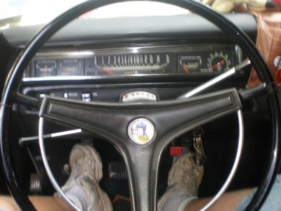

Update.....I sent my bezel off to Mr G's on friday the 3rd and got it back today. The price ended up being $70.00 plus 8 bucks shipping my bezel to them. Somehow it cost 16 bucks for them to ship back to me??? I would rate the bezel I received as above driver quality. It has alot of 0000 steelwool marks all over it. The whole bezel is chromed. I think the top is supposed to be black. Overall, I'm satified for what I paid for. Very fast turnaround!!!Thanks for all your help!

That still sounds better than the repop stuff it doesn't seem to fit right from what I hear. I bet its a bunch better than chrome paint would have looked.
