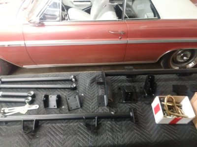

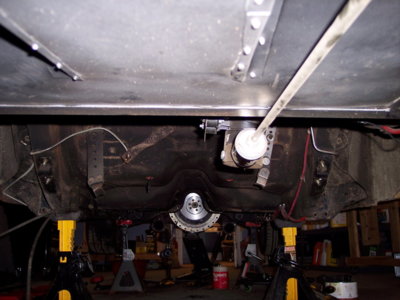

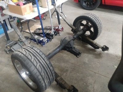

Up in the air and ready to start
Rear axle out

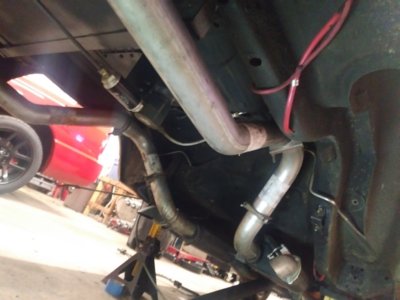

tail pipes are next
New triangulated four link rear suspension. Will be attached to Dana 60 new rear axle

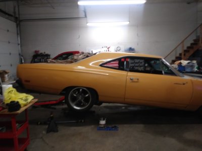

bob, we WILL be ready for race season. Should have tranny and clutch out tomorrow and get the clutch discs off to be rehubbed. Then I can put my passion 5 gear in

last weekend fun, rest of tailpipes removed, tranny removed. comes out a lot easier that it goes in. coming weekend will be bellhousing and clutch

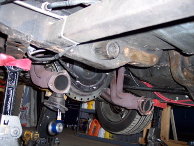

everything out all the way to the flywheel. clutch discs on their way to McLeod to be rehubbed, then I can start putting it all back together upgraded

this is true. I did not buy coated headers. probably should have. maybe i'll just cover them up with that heat wrap
RAINMANYEH
Sep 13, 2015
1,049
958
Birmingham, AL
My headers looked worse than yours before. Wish I had taken a before pic. You could wrap them or try VHT high temp paint. Mine still look good from a few years ago. Had them sandblasted first.
