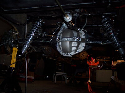

update time, Dana is installed, coilovers in, 4 link is installed, brake lines are made,
next question is does a 4 link need a rear swaybar??

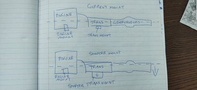

Have just ordered the A-body trans mount, which will fot the auto crossmember I have purchased for the swap (Brewers part # TC040), but is 5/16 shorter than the current mount I have (Mopar part number 2533 145). It will hopefully allow me to adjust the geometry of the trans+OD unit, which is currently sitting up WAAAAY too high in the tunnel. Looks like ill need almost 3/4 inch just to make it fir at the moment, let alone clearance it form the tunnel.
Hoping the shorter mount will allow me to see-saw it down a bit, and get the clearance required.

All rite. Need some advice. Trying to get the rear U joint holder off the pinion and Nothing I have tried so far will break that nut loose. Any ideas???
22,302
2,552
Put a huge pipe wrench on the yoke pin it against something and a breaker bar with a pipe. You will want a 6 point socket possibly an impact socket. Oh get someone strong like your wife :lol:
13,696
860
Just curious... Why are you wanting to yank the yoke off of a brand new (as far as I know...maybe I missed something) differential...?
quikbird
3,324
1,130
Sarasota, florida
Wrong size. Need a 1350 one. Diff came out of a truck I think and has a smaller u joint. New driveshaft is aluminum with 1350 u joints. Promised me I couldn’t break it. We’ll see
7,854
3,430
Yes a big socket and leverage. But if you have a heat gun not a hair dryer. Heat that nut up then try to get it loose. A little heat can go a long way's.
quikbird
3,324
1,130
Sarasota, florida
Thank you folks. bob’s advice was spot on. Bought a 3 foot pipe wrench and was just what I needed. Drive shaft is now installed
