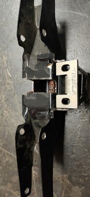

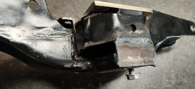

So the new trans mount I got is also too tall, leaving the trans and the GV unit up way high in the tunnel. So this Saturday, we'll be cutting out a section in the bottom of the crossmember - effectivley allowing the trans mount to shift up or down as required. We'll then slam the box in, and the trans will (hopefully) push the mount down through its positioning box, at which point we'll tack a plate in place to show the new mounting height of the trans mount, and then burn it into place.

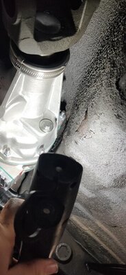

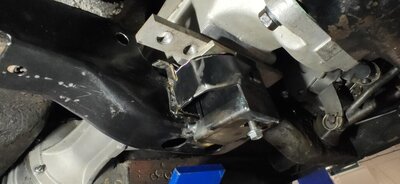

For some reason, in my case, it is definitely not enough. The holes are so far off that you cant see through them at all. We ended up fabbing up the little bucket that holds the trans mount about 3/4 inch lower, fitting the unit and the cross member, and then shimming above the trans mount to see how much higher we had to take it. I thought better if the bucket is lower, we can always shim it up, but if its high, it would all have to come out again.

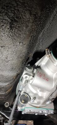

Also had to make a notch in the top of the cross member, where the lower spine of the GV unit was clashing. boxed it up and it finished real nice.
In the end, not too crazy a mod to the cross member, but definitely more than was called for in the GV literature. Don't think it was their fault though, how much can you trust a car geometry that you didnt put together yourself?

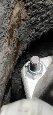

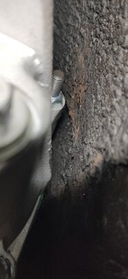

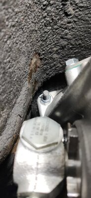

As for clearance, i took a pry bar to the tunnel, and just massaged it out slightly. I ended up with about 1/4 inch at all the tightest spots. My trans tunnel is not pristine like some of the cars you guys have, so maybe something to think about before you go down this route. thumbnail_IMG20200711103407.jpg thumbnail_IMG20200711103413.jpg thumbnail_IMG20200711110737.jpg thumbnail_IMG20200711110750.jpg thumbnail_IMG20200711110757.jpg thumbnail_IMG20200711110809.jpg thumbnail_IMG20200711110815.jpg thumbnail_IMG20200711110914.jpg
