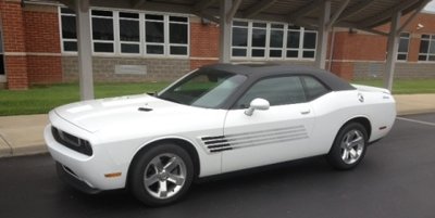

    Yes, foam double sided tape. I used it to install the pot metal rallye moldings on my Challenger. Been on there almost 2 years and no issues. photo(1)resize.jpg
