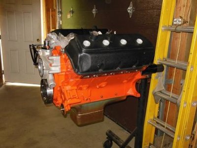

I have to get the Studs and gaskets for the Valve Covers. You guys have a tip or preference on where or best quality?
Thanks
22,145
2,356
Thank you!
Thanks

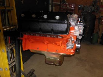

Looks good Joe, what's in it?
Not the best stuff but I have ran their stuff before!
Eagle Crank and Eagle H Beam Rods
JE Pistons
Stock Cast Heads
Mopar Factory replacement Solid cam!
Mellings HV Pump and Deep Pan and Windage Tray!

Joe I take it your at standard stroke how about compression. And make sure you run a good oil with those solids, I have the same cam and no issues, works to 7000rpm and wants to keep going but I don't
