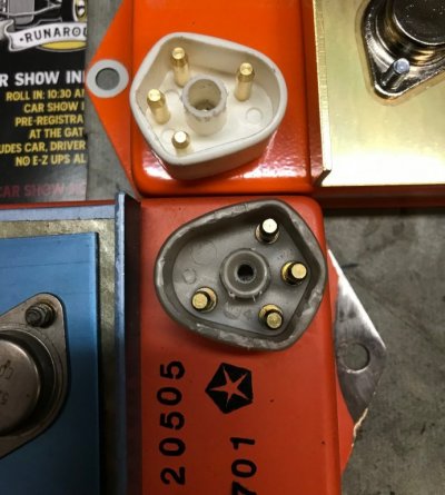

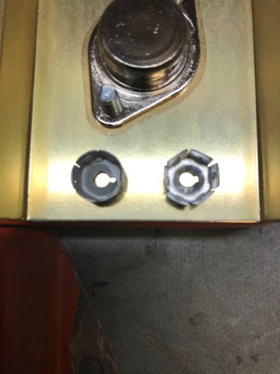

Tell me about it. The nut on the new orange box that the long screw holds the connector on to just pulled right off. I had to dig it out of the connector. Looks like the old box was an original Chrysler type. The center of the old connector is solid and threaded. The nut was much more substantial too. Here are some pictures. I filled in the hole with epoxy then drilled and taped it to be like the original, don't have a picture of that repair, sorry but it's tight as hell now. Having everything made in damn China is going to bite this country in the ass big time one day.
