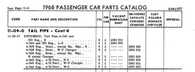

Screen shot from 68 parts catalog. Note 426 engine and 426 hemi. No 383.

84
I stand corrected on the decor package and you know... thinking about it, I should have remembered that because it included the rear trunk finish panel. I'm still not convinced that the tips came with the package though.
Either way, it's obvious the car in question doesn't have the trunk trim and B pillar trim, so this particular car would not have come with tips.
