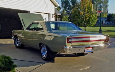

I'm pretty sure that it didn't get the tips.

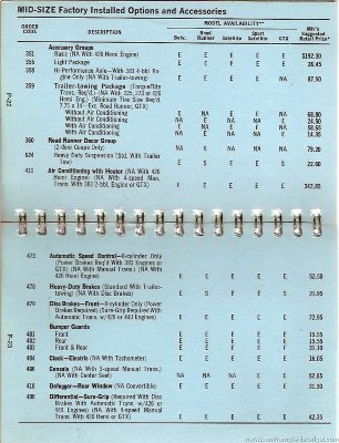

John is correct, no tips in '68 even on a RR hardtop that came standard with the décor package. When I restored my '68 HT I did lots and lots of research on the tips because I wanted to put them on but no luck finding info that I could have even ordered them back in the day so I didn't put them on :frown:
In '69 you couldn't get the tips on anything California sold and delivered in the State (GTX or RR) because of a noise regulation. Same with an un-silenced air filter cover in CA.

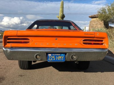

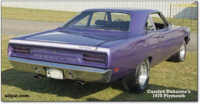

So I have turned down on my car do you think I could buy the tips and hangers cut the pipes and slip on the new Tips?

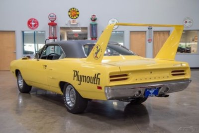

IMHO perfect as is for 1970. Still don’t recall them even on Superbirds. Makes me think will look now...... So much for that, yes easy to add on. Went through 3 exhaust systems and retained tips. Don’t forget hangers, may have to realign tailpipes a bit.

Heat rises and they always summited up the rear bumper. Bet you cant touch one after the car has run for a while. :beep:

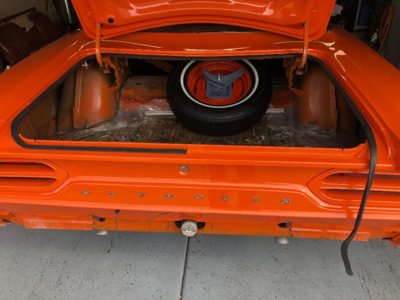

Oh then maybe I shouldn’t put them on I have a reproduction bumper and I don’t want it getting messed up

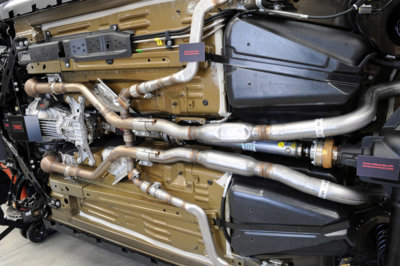

Always thought it may of been the leaded gas- something in that to ruin bumper. Yes, pipes can get hot but bumper and rubber grommet hangars always seemed OK. Don’t underestimate heat signature though; on Boss 302 forum they’ve had the side pipes melt/distort rear fender area from excessive heat and a few with tailpipes against rear cutout fascia, pretty good meltdown. Those ones changed the axle back mufflers and forgot to tighten or align I guess.
LOL, but yeah am talking about plastic parts car compared to a solid metal. I don’t really laugh, just snicker. But they are lighter and aluminum hoods- dissimilar metal corrosion there, can’t win...... looks like this:
