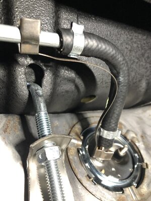

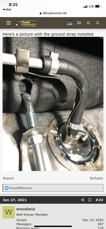

The nice install on that grounding strap looks great. My question is: Does there have to be a grounding strap? My gas gauge works perfectly if that makes any difference.
7,704
should be a strap between the sending unit and fuel line if you have not put one their. Found mine on e bay. Their is a short one and a long one. Should be the one for B body cars. Like the one shown by 68 man.
1968 man
Jan 15, 2020
840
1,113
Columbia South Carolina
The ground strap is for safety, it grounds the fuel line to the tank and sending unit where it is separated by the rubber hose. I think that’s right. Someone may chime in and explain.
