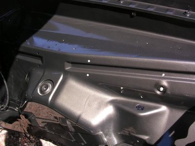

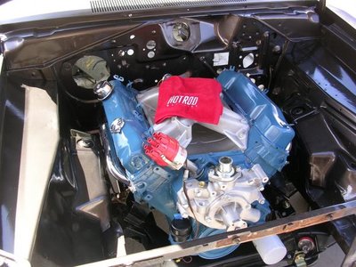

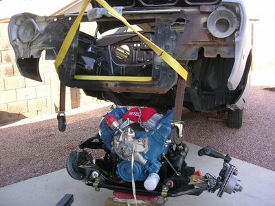

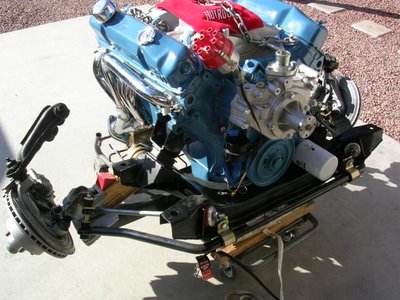

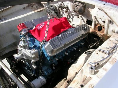

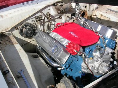

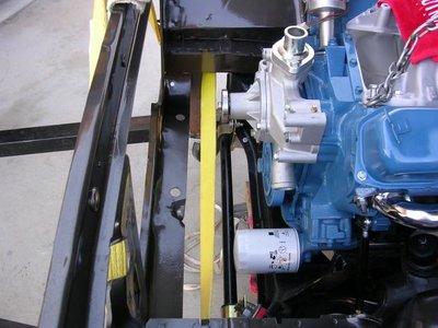

Did some mock up today. Set it down on the K-frame and dropped the 440 in so I could see what needs relocated on the fire wall. Blower motor has to go Chris was right on with that call, everything else looks good. I need to call Vintage air and see where everything connects. Guess I'll be welding some holes up.

440 powered,love it.It must be great to work on the car outside at this time of year and not be freezing your ass off.

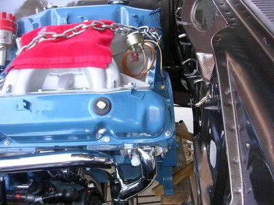

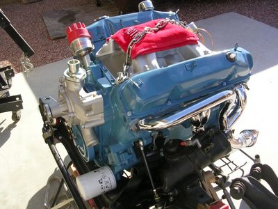

OK Basketcase, ACME Shipping came through, I got the valve covers. I think I'm going to take the intake down to the powder coat outfit and have them put a ceramic finish on it.
How do like the fit of them tri-Y headers ??
22,148
2,358
They have a nice fit with the power steering and starter,TTI makes them for Schumacher

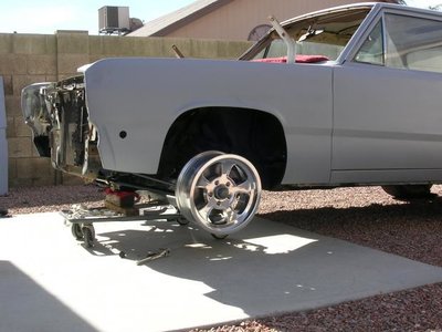

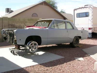

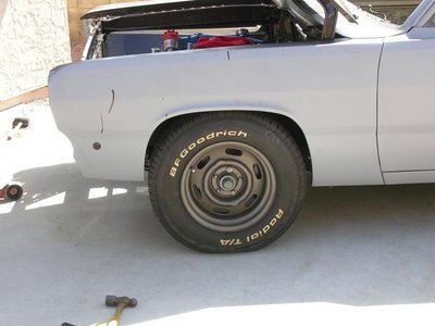

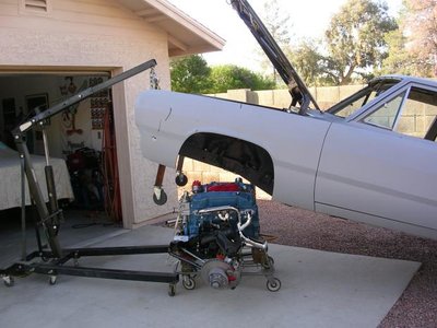

Another nice day in paradise. The tires are just rollers and a bit tall for the front.
that's slick, but I'd rather leave the car on the ground. Engine looks like a good fit.
