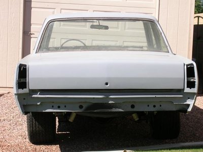

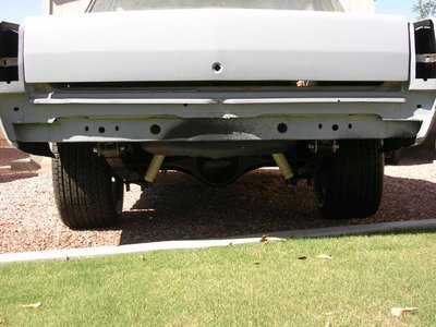

That's lookin' good Bob. And that's a nice tight fit. How's it gonna be to get at the plugs on that thing?
22,148
2,358
Actually not bad the headers are well designed. The 1" torsion bars were the hardest part to get in they are not clocked on the hex like the factory bars
10,540
286

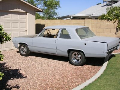

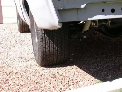

Yeah Bob, that looks good! I like the stance on that thing. Is that how it's gonna be when finished?
22,148
2,358
Yep I just have to weld the sliders in after the car is fully loaded down, but it should set almost flat a bit up in the back. I am very happy at this point.

yeah.....bobbie......she sits nice.....see what happens with a full tank of gas......are you locating the battery in the trunk too for more traction??....you going to drag race it too??
22,148
2,358
The battery is going to the truck or boot incase Steve reads this. Racing might happen. :D
we just ignore Bobbies little ramblings Steve, the heat gets to him this time of year........
