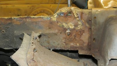

Some friends and I were talking about some of the work my 69 rr needs done to it. The issue currently is the inner fenders. when i pulled the engine over the winter and the outer fenders we discovered some rust issues at the top rear of the panel where it attaches to the cowl. someone ( a previous annon. owner) has cobbled on this area. the question we bounced around was that just cut out the areas of rust and place a new panel over them and lap and plug weld the new panel in place without undoing all those spot welds around the shock tower etc which are still in good shape. this would give me a double layer over most of the panel. Any thoughts, conceerns on this or is it pull the whole panel and weld in. I already have both complete panels.

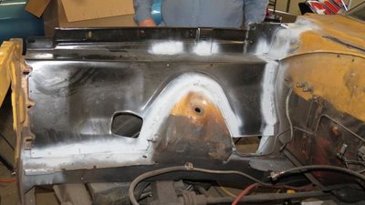

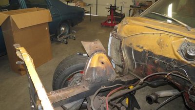

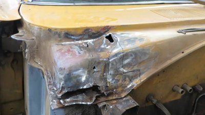

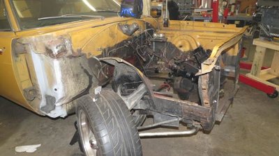

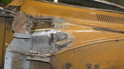

progress report with pics. pulled the passenger side inner fender panel:

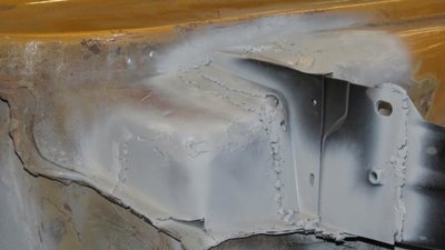

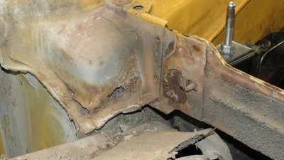

I knew I was going to have issues with the front corner of the cowl, but the hits just keep on coming.

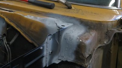

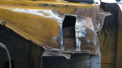

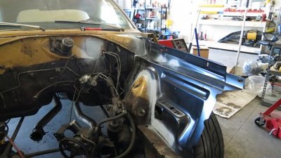

inner pieces welded up, not too pretty but its the second time I ever tried to weld

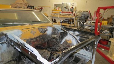

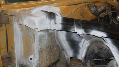

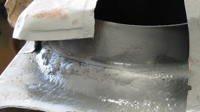

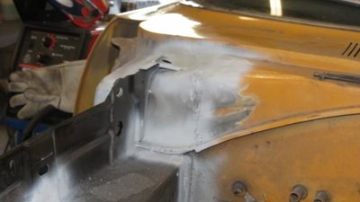

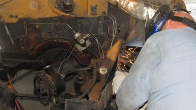

on to side two with the same rust problem
ego boosting welding shot

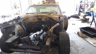

and side two is finished

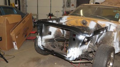

next weekend, get to square it up and install the new core support. yee haw!!

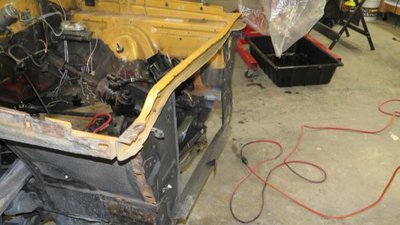

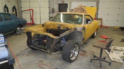

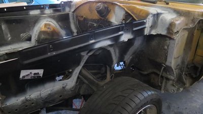

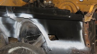

got the core support in last weekend
next up is install the magnum force shock tower braces and pull everything left in the engine compartment and get ready to paint engine compartment.

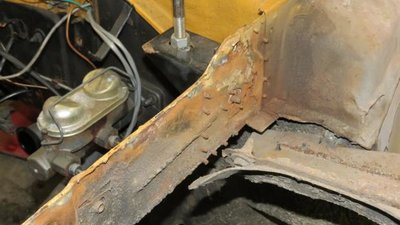

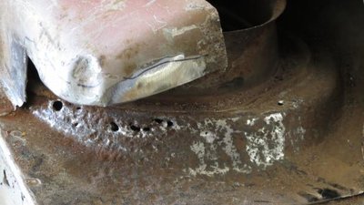

I have officially decided that I hate spot welds with a passion

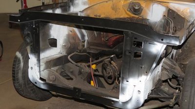

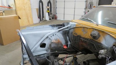

here we go with the magnum force shock tower braces in place
looks like time to pull the power steering unit and start prepping for paint in the engine bay
