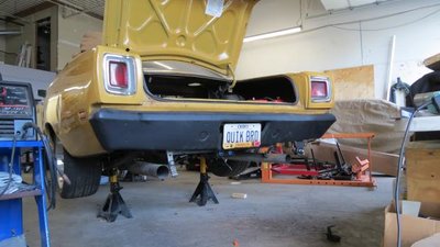

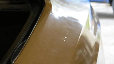

here is a picture of the rear quarter and it certainly looks like a fair amount of filler

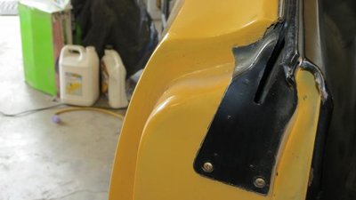

also have some photos of the rear quarters. if you look closely at the top edge about a couple inches in you will see a nice row of bumps down the fender. Pretty sure these are pop rivet heads from where they attached the fender. also a picture of the inside of the fender as promised showing all the &*%$#(*&^^ rivits

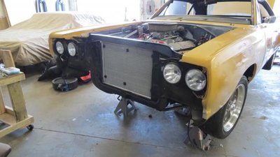

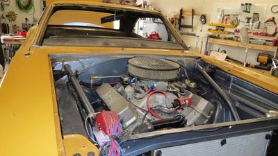

engine compartment almost done, just needs the pins for the hood set and a few touchup things

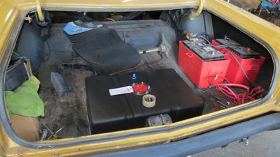

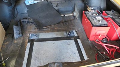

have most of the frame done for the fuel cell, just have to weld it into the car

looks like the same body shop did my car too.....not a weld in sight on the old quarters...but a TON of rivets....

Both of my quarters were pop riveted on and body filled over. Both sides didn't match either. I've been there I totally know what you're feeling

also got some work done on fuel cell framing and test fit the fuel cell.

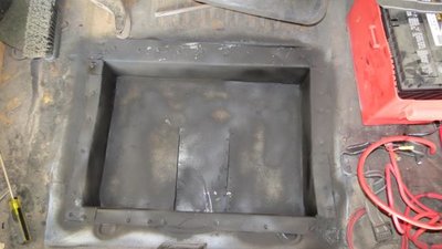

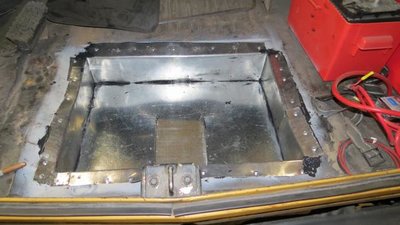

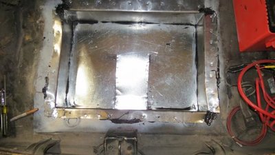

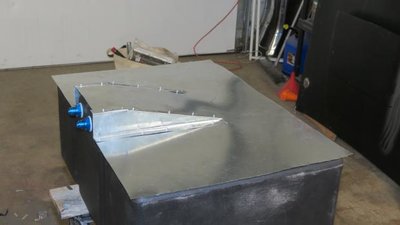

progress report from last weekend; As usual I outsmarted myself and ended up with more work than I needed. I got frugal and purchased a plastic fuel cell as previously shown, then discovered that according to nhra rules if the tank is outside the body, it needs to be covered in some way with metal of a certain thickness. so this weekend I finished building the tank cover.

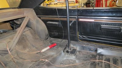

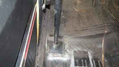

while waiting on the undercoating on the tank cover to dry got started on the roll bar:
as mentioned on a diferent thread I am looking for advice on where to run the rear bars. I would like to keep a rear seat in the car but this may not permit that

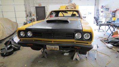

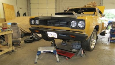

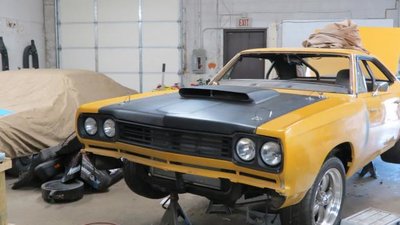

Okay. I think this post will just about wrap up the thread. I'm not done with the car but since I started this one on a front inner fender it seems kind of fitting to wrap up with the front end of the car pretty much done. As to the rest of the stuff I will start some new threads in the appropriate areas.
so here are the final pictures of the front end all finished up. it took most of a day to get the hood pins set, and another one to finish the headlight/ turn signal wiring bumper installation.
I think I am done with this end of the car until it is time to paint, hopefully this winter.
