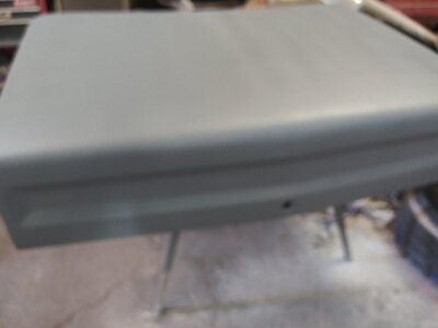

Look like some one punched the lock on this lid. Yes and a few dent in the tail panel are. But was able to work it all out with a bar I made so I could reach in and hammer out those dents. Top was not really a dent like it was struck by something. More like depression's. But glad to here you got yours out. It is sad they don't make a reproduction lid. Think mine was a donor because in the top corner's it wanted to hit the filler panel on both sides where the quarter met up. So had to grind down the corners and Mig it back in. Keep it up your getting their. :thumbsup2:

i replaced the deck filler on mine when we test fit the trunk lid it fit very good

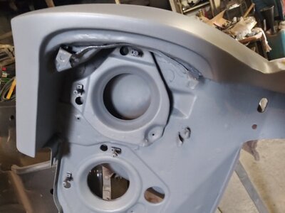

it has bine a journey had to replace both front frame rails and the torsion bar frame both front inner fenders

I was lucky on that part. Only the crossmember had a little rot in it. On the passenger side. Very small hole so welded up a quarter inch steel box with out the top. Open side up and used my tig to weld it in with the stinger on the tig machine. That inverter really weld's not like the old buzz box welder. So figured it is stronger than it was before. Good luck keep at it your getting close to paint. I am in the engine bay wiring up the motor now. Waiting on some part's is killing me. But that is apart of building these car's. :thumbsup2:

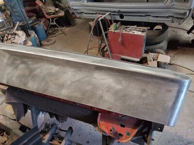

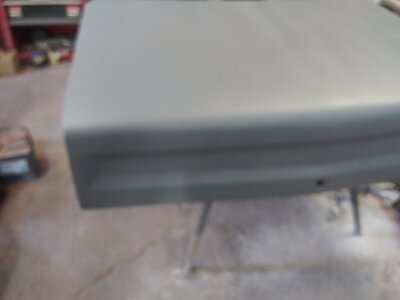

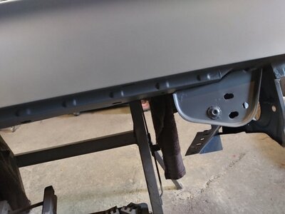

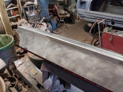

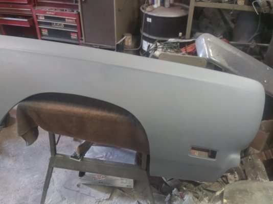

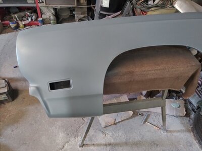

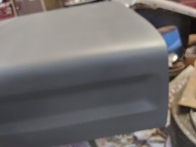

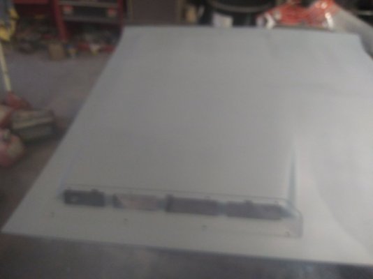

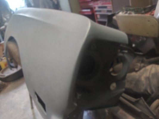

ok Russ here is some pics Finish striping the jam and fix the crease then get some primer on it

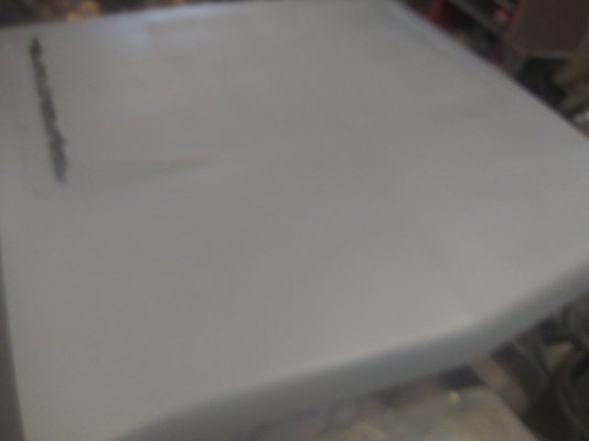

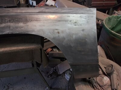

got the hood striped some small dents and dings no rust i am happy
