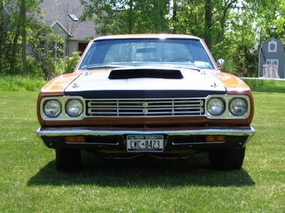

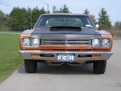

i did mine with a home brew of paint. for my driver, i think it looks pretty damn good. i think i used a semi flat or semi gloss. i will try to check. i might have kept some notes.

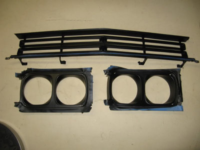

first i cleaned and polished all surfaces. masked off all everything else. sprayed on semi-flat black. let that dry good. masked off again the areas to be left black and then used a multi layer process. rust-loeum multicolor textured paint #223525 aged iron paint and silver. i did a lot of practice until i got what i thought looked good on an old headlight bezel. the trick for me was finding the right distance to spray to get the texture i wanted and the right look of the silver. practice, practice, practice. this of course was done when the snow if flying so i had the time to play.

Your first photo of the grille looks exactly like mine. So to be clear you masked off the areas that were to be polished metal.....painted everything black. Next step was to paint the inside of the headlight bezels and the inside of the horizontal grille inserts a silver-grey color? The finished product is awesome. My original thought was that it was all semi flat black except for the polished metal areas. The silver grey is a new one for me. Thanks

i have an original grill to compare with where the different finishes go. i know it isn't "factory correct", but it looks close enough for me.

i had it all polished and after it was masked off i used a scotch brite pad to just give it a dull look before the paint.
