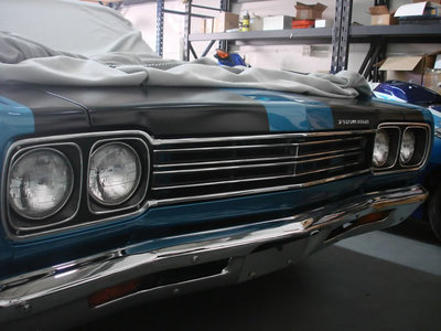

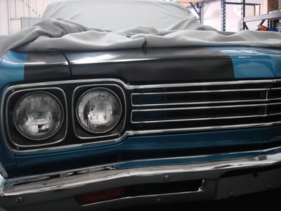

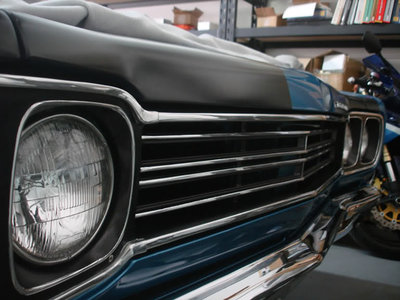

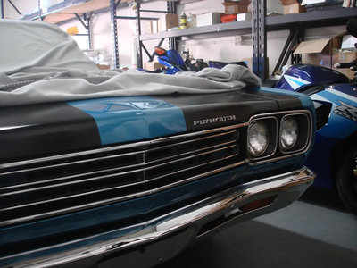

I just painted the grill. Took about 7 hours to mask over a period of three days. I think I will do an extensive write up on how not to paint a grill. I skipped one important step because I was rushing to get this done in time for the Spring Fling at Woodley Park. I should have bright dipped or electropolished. The next step would have been to do a clear anodize. One of the things I noticed was that the paint was having a tough time adhering to the polished aluminum. I found out about a paint adhering agent. Bulldog and SEM make it in a rattle can. I found out about this after the paint I used was not sticking to well to the polished surfaces. Essentially I will be doing it again so that I wont have to do it for another ten years.. Thanks Jim for the dark argent. I opted to save it for the next time and used the Krylon black fusion paint. This will only be on for the rest of the week and then it's off to get it stripped and re polished. I should be able to strip the existing paint without too much damage to the polished surface. Anyways I will post some pictures in the morning. It definitely looks good.
Jim S.
Aug 3, 2009
1,798
White Bear Lake, Mn.
Sounds good. Yes I had to scotchbrite the areas that were to be painted dark argent after masking. Hopefully your Dad can reproduce it. It seems very hard to find anymore and I don't think I can get my body shop buddy to match it again. He quit drinking, I bribed him with beer last time. I will be curious to see how the Krylon fusion looks compared to the good stuff. I don't know how good Bulldog would work on aluminum. Works great on plastic and vinyl. Looking forward to the pics. :thumbsup:
