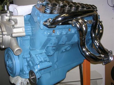

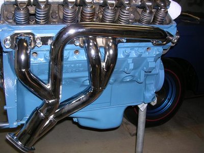

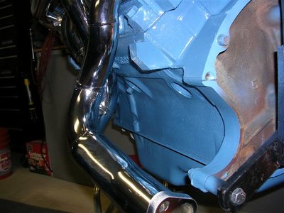

I was just test fitting these Schumacher TriYs and they allow room for any starter. Are they as efficient as full length headers? No, but I'm not going to open them up anyway, maybe cutouts. Excuse the lack of valve covers :acme:

Nice fit! They look good too. I may have to big block one of my A bodies. I wouldn't waste my time with cutouts. A 2.5 system with good mufflers and mandrel bends would outflow those headers every day of the week and twice on Sunday.

Thanks for adding the pic's thoe headers look sweet! A lot of room for a starter, and the number three plug area seems to have enough room to keep from burning the boot. Nice! Who is the manufacturer?

http://www.engine-swaps.com/Pages/Produ ... aders.html They are made for A bodies but I bet they will fit anything, give them a call. I made a purchase during Carlisle last year and they have a really good show price

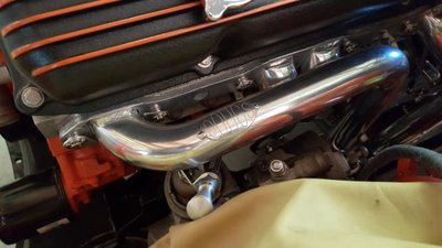

I just put a set on my 400 stroked, 1 7/8" (same for 440), ceramic coated. I also used Stage 8 locking fasteners and Remflex gaskets. IMOP, I wouldn't go with the 2". I've was debating between Doug's and TTi's and went with Doug's. Fit, ease, and overall quality is great. I thought there might be an issue because I have P/S and larger torsion bars. These headers fit with a little space between them and the bars. On Doug's site, they're on back order but Summit had them in stock and I used a discount code for even more savings and free shippingHeader R side.jpgHeader D side.jpg. I think you would be glad with them.
