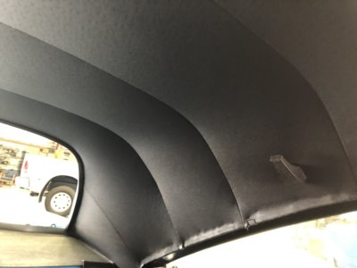

Good looking job their 1968 man. Hope mine turn's out that good. Had forgotten to put a screw hole in the back of the where the package tray is close to the window for the bottom of the saw tooth piece on both side's. I had to make those pieces of metal they where rusted out. Did not know what holes needed to be their.
