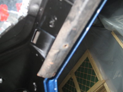

They hold the headliner in place along the side as you work all the wrinkles out then you remove them to apply adhesive along the edge no more than 1/4 of an inch. then you can put them back if you like, but it makes it a tight fit for interior trim that run along the sides. I removed them several times and put them back as I worked on the head liner, I only used them to hold everything in place.

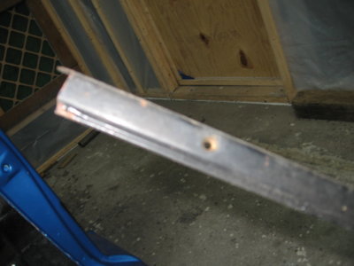

The trim pieces have there own clips that slide in the back plus screws on the ends. Also the clips are u shaped that go in the back side of the trim. Hope this helps.

Yes finely see them in my b body restoration book. I have a post car and in that trim is a screw hole about two inches from the end at the front. Darn is I can see what it would screw to. This car has so many part's guess I should have documented every part when taking it apart. I did label the bag they where in. These S clips where in really bad shape and RT specialties had them but had to take a breath at the cost of them. Thanks for the Help 1968 man. Trying to move forward the best I can. :thankyou:
