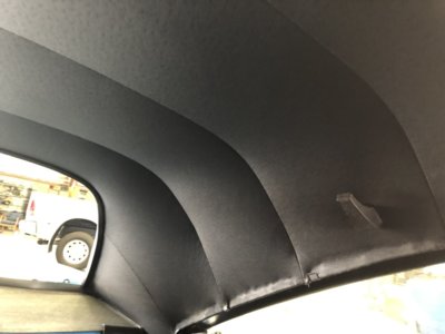

Yes Big Mo I put mine in myself because I watched the guy install my friends and he was doing both of ours the same day and after seeing the poor job he done on my buddies I said no thanks. start in the back with the rear hanger and hook the two rear clips on the hanger and the window frame ,tuck material in about a foot of the tack strip around the back window, then pull the material to the front, and repeat ,it takes time and patient .It helps to let it hang in place for a day and do it on warm day if you can . when you glue it down the side only a 1\4 inch of glue along the edge so your metal trim covers the glued area.it makes for a better looking job.

I found out the hard way, mine was shipped and when I got ready to install there was not enough of material in the sail panel area, they sent a headliner for a 69 not a 68 and had to send back and wait for the right one. IMG_4192.JPG

I found out the hard way, mine was shipped and when I got ready to install there was not enough of material in the sail panel area, they sent a headliner for a 69 not a 68 and had to send back and wait for the right one. View attachment 30681
