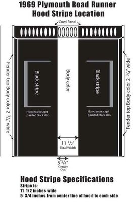

I found a drawing on the site somewhere showing the location of the hood stripes....but can't find it now. anyone know where it is? Thanks B
Reference section under "paint"

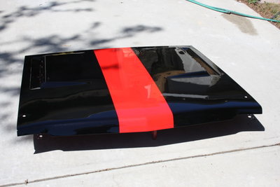

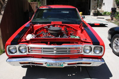

BBillyC
Mar 2, 2009
460
Winnipeg, Canada
Yep, after having previously owned two other 69's and dealing with the flat black was a pain. I really liked Georges glossy so if I was going to change may as well go all the way to reach a compromise. I used a black pearl acrylic single stage. I had also mixed in some pearl and some ultra fine purple, red, yellow and blue to set it off in the sunshine. At the car show the other night my wife said someone commented on how great the stripes looked with the color offset. Different yes, is it original....no, but I like it and it is subtle and classy. If some future owner (after I'm croaked) wants to change it I absolutely won't care.
